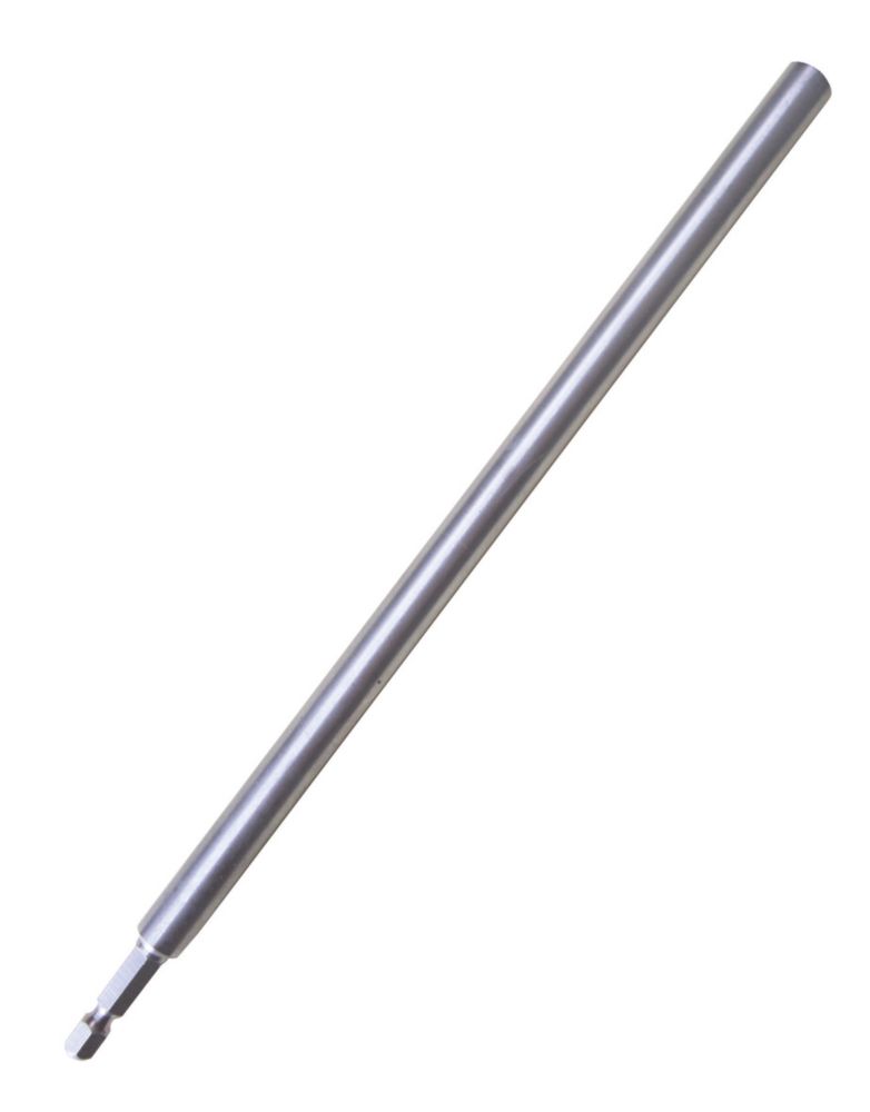

Get yourself one of these mate.

Just get one of those cheap drywall bits with the plastic end that prevents screw pulling in to far, about a quid.

I tried one of these designed for drywall and found it naff. Reviews are good and I treated myself at £13
Wera Ringmagnet. Anyone like it?
Better with a long bar as I said in above post imo
