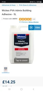

Thank you! Very helpful! I got this glue. Would you say 2nd tacky coat should be 2:1 or 1:1 with this one?
How long after bonding do you do the first coat of PVA?
Also, I have some smaller cracks I'm going to scrim and plaster over with multifinish but was just wondering should I do it the day before skimming and let dry first or just do it say half an hour/ before skimming?
Thanks again. Feeling the fear before starting this job so want to have the process super clear.

That's Bostik
It's ok - pretty good
I'd say 2-1
But totally depends on substrate suction and you and your speed.
Tacky or dry shouldn't matter
(Ideally glued on the day for me)
Don't like next day jobbies
