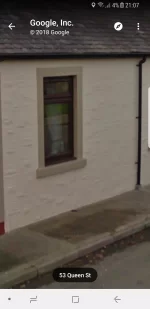

Picture of exterior
Is the drip on that window clear? All the pictures you posted show damp around windows and the external pic looks like the window sill is sitting straight on top of the concrete sill which will let the water bypass the drip and get inside. I may be wrong as my eyes aren’t that good any more
If the paint is in a poor state it could be trapping moisture and bleed through inside. These things tend to be more than one contributing factor
