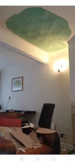

DONT USE !!!! Had a major fail with this rubbish and bostick technical guys don’t want to know, cu nts!
I've had 2 with it... It was shocking how easy i removed the whole ceiling...

Are you feeling a little bit worried at this point matey?
Guaranteed till I pull off the drive Andy.
I have noticed a few issues with it myself, and I think that you’ve got to be careful what it’s going over as you can still end up with high suction areas and Ivhave noticed you can get bits lifting occasionally, a bit like blebs over bonding. It does say about using SBR in certain circumstances but never tried it.

Mechanical key with grit rather than chemical keying so on a ceiling it drops especially with the thicker coating to get over artex
