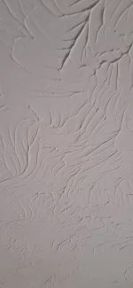

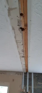

Hi there, firstly I'm not a plasterer but I'm looking for help/advice. I have removed a wall between my dining room and kitchen to open the room up and have a new kitchen fitted (all on hold at the minute due to this virus). The ceiling is artexed, broken leather.

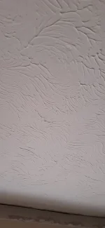

I would like to keep the artex, I like the pattern and the rest of the ceilings are done the same.

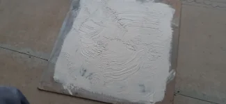

I'm struggling to find anyone who could repair the ceiling and patch the artex. I was going to ask the plasterer to board the ceiling where the wall has been removed and I would do it. I've had a practice with artex on a sheet of ply with a sponge in a polythene bag but I cant get the pattern quite right. Tried using different sponges, plastic bags and having the artex thinner/ thicker. I haven't tried an artexing brush yet to create the pattern.
Any advice would be appreciated.

Try wrapping a roller with a plastic bag or cling film with folds a creased in it. You will struggle to get a perfect match anyway because the thickness either side of the old wall will differ. Your best option for optimum finish is overboard and skim the lot though.

That will be almost impossible to match in. By the time its patched, taped and filled out it will be lower than the other edges and will stick out like a sore thumb. I've tried it loads of times on ceilings that have had leaks and I end up Skimming the ceiling or the customer has a go at trying to match it, makes an ar*e of it and I end up Skimming the ceiling.
any decent spread would be able to match that with a slap n drag of trowel on wet skim,done it loads of times and on stipple as well.
the ceiling needs an overboard, you have 2 straight joints right across your ceiling , a fault , creating a weak spot which may crack.
I would advise my customer to skim that. Patching in a corner or small area can be done but it's a lottery if it will show. Either skim ceiling or artex over the lot..
That's going to be instant eye grabber when patched in, no matter how good you are. Artex patches like that are always noticeable, to the point you'll probably end up getting it skimmed at some point in the future.
Better to do it now.
