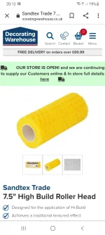

Hiya guys. Have been asked to match this finish.. Was thinking to knock up a wet slurry and roll it over (long ply roller) once top coat is starting to set.

When using the roller, put elastic rubber bands over the roller to get heavy affect.
