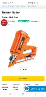

get rid of the metal
hire a gas gun
pin the timbers in
and away you go
put ear protectors in
